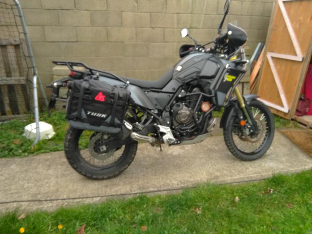

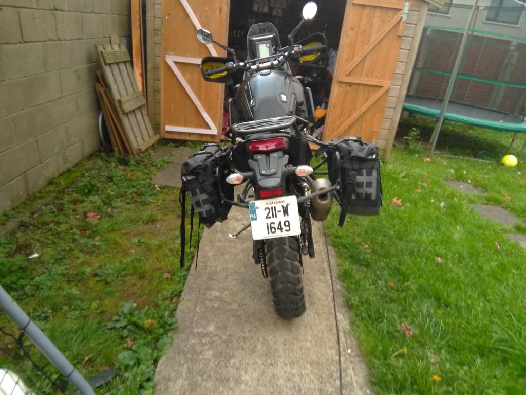

electric_monk 4 Oct 2021 19:38
Does my butt look big in this...
1 Attachment(s)
So after much prevarication I decided on the touratech racks with the old Darrs boxes. I bought a set of mounts from Motea and they work very well. Fortunately they centre up within 2mm of dead centre.
Tomkat 5 Oct 2021 17:43
That's the advantage of having asymmetric bags when your racks themselves are asymmetric. That's why I use Kriega's OS-22 and OS-32 bags.

I have now got my hands on a set of Tush soft pannier which attach very well with the Touratech racks.
They are a great fit and spacious. The outer bags are only water resistant but they came with waterproof inner bags.
